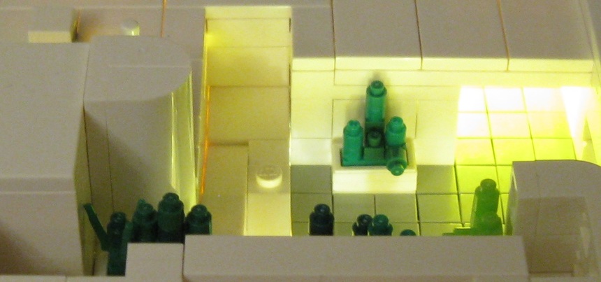

  • Create more convincing plants in the garden areas of the roof

Four Pico lights and one LED light strip were installed onto this upper level. I particularly wanted one of the Pico LED’s to illuminate the gray open area on the roof.
In order to create a stud-less roof design, I had to add one layer of bricks on all four walls before covering everything with white tiles. Adding this layer required adjusting the height of some of the roof structures so that everything balanced out. Not happy with the original Lego version of greenery in the open area of the roof, I created green plants from nanoblocks and glued them into upside-down Lego tiles (which made nice “planters”).
