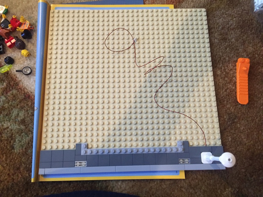

So, on the build!  We'll start with the first floor:
A quick note about the placement of the power button here.  Make sure that you leave enough slack on the line coming out of the back of the building to move the power button from where you see it here as in that position, it would block the service doors to the elevator shaft.  It actually fits better centrally located behind the building, which is where mine eventually ended up.  Also, make sure to leave out the blocks that I mentioned in the specific instructions, as you can hide the 1x9 expansion beneath the sub-floor if you leave a gap down there (in these pictures, they were in place but I did remove them later so I could tuck the 1x9 in the gap).

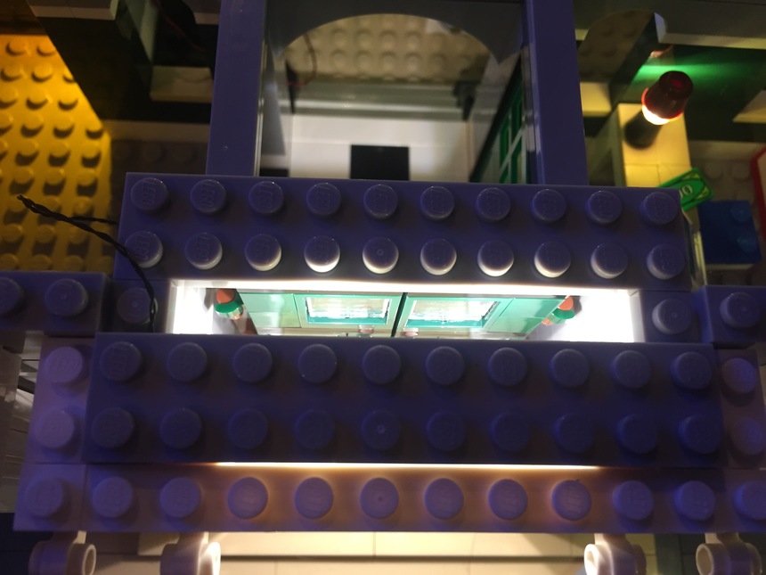

Another note here about the front doors -- the light will slightly impede the opening of the doors, but not too badly.  You just have to be a little careful when opening the doors in the front of the building.

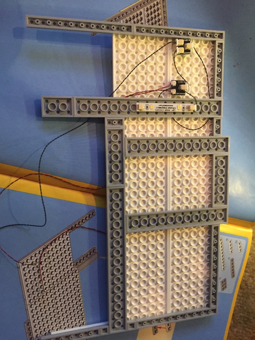

Now, on to the second floor:

  • First Floor: run line for street lamp (page 5)
  • First Floor: do not install the 1x6 block at the bottom of the elevator shaft (page 11)
  • First Floor: do not install the 1x6 block at the bottom of the elevator shaft (page 14)
  • First Floor: one (1) warm white pico LED for elevator button (replace button with set with translucent orange 1x1 round brick) (page 25)
  • First Floor: warm white pico LED on the desk lamp (install on page 15 and then complete on page 26); also install 6” extension cable for light strip over door (may have to use 12” however; depends on where 1x2 will be from lamp post)

  • Second Floor: two (2) light strips on underside floor (for first floor lighting) (book 2 page 6)
  • Second Floor: one (1) warm white pico LED on desk lamp (book 2 page 20)
