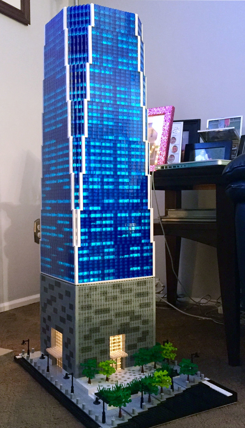

    Hello,
    Not sure if you remember this thread but I'm still working on my Lego One World Trade Center and the image attached shows it lit entirely with Brick Stuff lights. I was just wondering, I currently have 3 high powered LEDs in the tower, and 16 pico lights in the base (street light/accent lighting) and 8 in the spire all connected to a single power source (iphone usb charger). Is it safe to add any more lights? I was thinking about adding more to the spire, but I just wanted to make sure my current setup (especially with the 3 high powered lights) will support that. Thanks so much!
    Greg DiNapoli
    • 9 yrs ago
    Hi Greg, thanks for sharing that photo.  All I can say is WOW!  It looks so realistic.  Were you happy with the way in which the high-powered LEDs illuminated the interior?  From the photo, everything looks evenly lit.  Again, just a fantastic job.
    Regarding adding more lights, as long as you're adding more Pico LEDs vs. high-power LEDs, you should be ok.  Though I might recommend adding the new Pico LEDs to a new "home run" from the main power supply, just so you don't end up with dim lights at the end of your existing daisy chain.  Hopefully this makes sense-- let me know if you have any additional questions.  Thank you!
    • Greg_DiNapoli
    • 9 yrs ago
    Rob Klingberg Thanks so much. I still have about a foot to go for the towers height, and so far I am pleased with how the high powered lights illuminate my design. Using 3 of those high powered lights, is there a limit of pico lights that I can use? As I said I already have about 24 in the chain. I'm trying to make the spire stand out more and I just want to make sure I don't overload anything. Thanks again!
    • 9 yrs ago
    Greg DiNapoli The power supply you are using is fairly robust.  You won't burn out any of the LEDs, so you won't need to worry about that.  If the additional Picos toward the end of your string start looking dim, you should run another home run down to the main power supply for the Picos in the spire.
    Good luck!  And keep sending those great photos.
