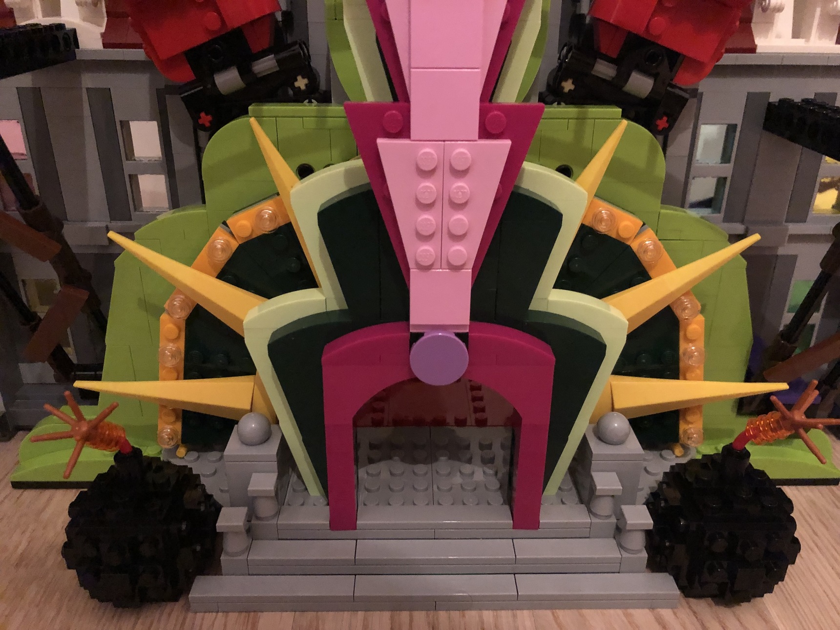

    Hello Rob Klingberg ,
    I'm just playing around with the lighting for the Joker Manor and wondering if you can use the Effect Controller to turn on the lights like in my docking bay. The lights should run one after the other in a circle ... is that possible?

    Freakmaster Completely possible.  ;)   I presume we're talking about a "marquee" effect, or where the lights appear to chase themselves around in a circle.  (Your docking bay gave me the idea of runway lights for Santa Claus, - third photo/video and these are also seen in a few kits including the Ferris Wheel.)

    Freakmaster it’s a specific controller with the master/daughter boards... what controller are you using?  It *looks* like the 12-effect controller, but that one doesn't include a chase effect... exactly.  That one is a two-channel controller, so you COULD have alternating lights flash on and off, and dialing up the speed get close to the chase effect.
    The marquee itself - a sequence of chasing down 3-4 lights, involves the a series of daughter boards in series - much as your Docking Bay setup was setup.  (This controller isn't - at last check - "on the shelf" online, rather, it's a special order/request via email + PayPal invoice.)
    Doable, but it's more and different parts... :)
    • 6 yrs ago
    Freakmaster We do have a marquee controller-- we sell it along with our handmade kit for the Palace Cinema.  Here's a demo:
    The way this works is that there are four total outputs on the controller.  Three are used for the sequential marquee effect (1,2,3) so you can connect as many lights to each of those three outputs as possible.  The 4th output is for flashing lights (on/off/on/off-- they are used in the front lights for the marquee as shown in the video).
    You could easily adapt this for your Joker Manor sign.  There is a speed dial on the controller, so you can make the lights chase as fast as you want.
    Is this what you had in mind?

    Rob Klingberg
    That's exactly what I had in mind😄
    I was not aware that I needed an extra controller for it. I thought I could use the Airport Runway style effect. I had overlooked the "pulsing".
    That means that only the "special" controller would suffice for me?
    • 6 yrs ago
    Freakmaster I think the special controller is the least expensive option-- the Airport Runway style effect requires one controller for every 3 LEDs.
