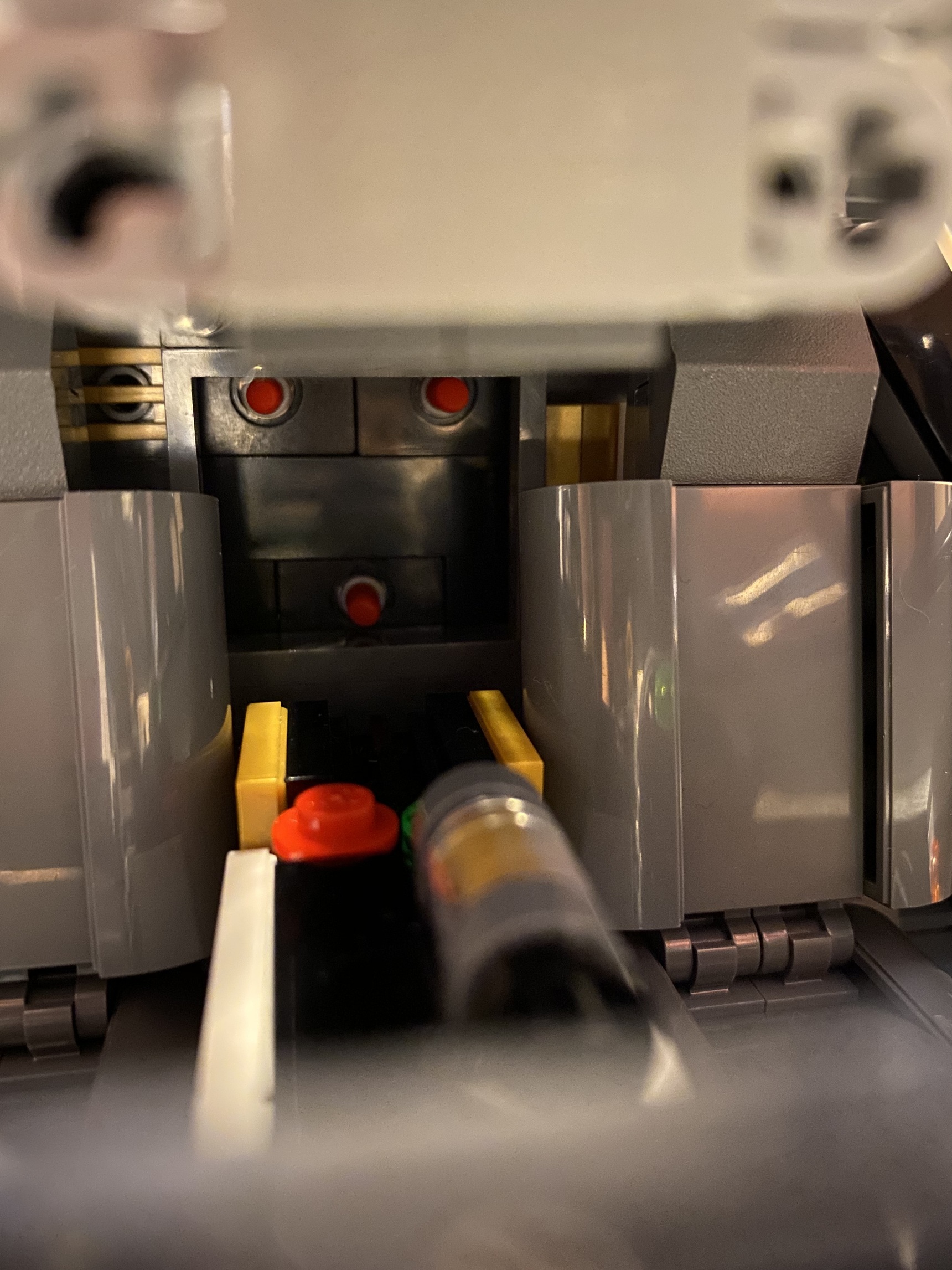

    First try for the time machine panel. Maybe I should use another effect?

    Freakmaster I think that looks really good!

    A little Update...
    • Freakmaster
    • 6 yrs ago
    Rob Klingberg
    To your post:
    Ah yes, a beautiful model!  We have it also, and have been playing around with some custom ideas for several months.  I want to see if we can do something around the "Christmas Tree" panel behind the drivers' seat.  Looking forward to your ideas....
    Do you mean this item in the first picture?
    I tried some effects, see the video.
    • 6 yrs ago
